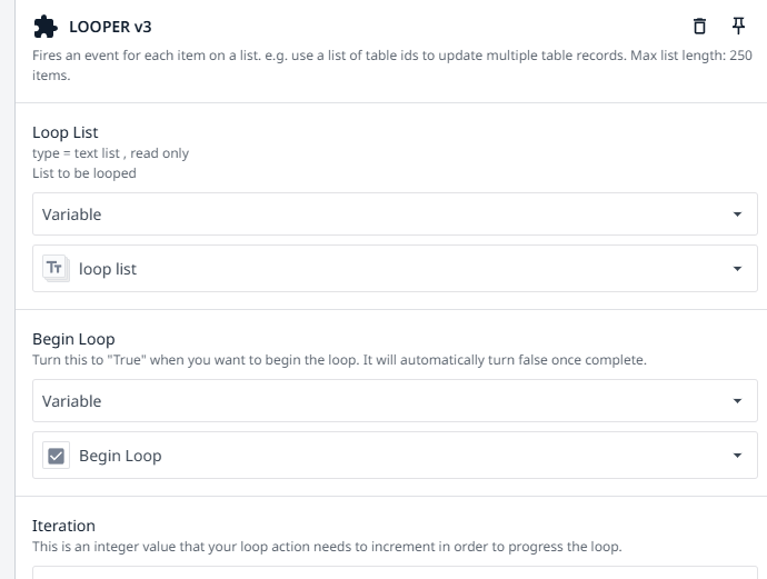

LOOPER v2 not working correctly when started from step enter trigger
:smiley: No it’s not your fault.
It is simply a disabled functionality on our instance.
There we go… the default value of your counter is already 1 !
This will call the second value by the first iteration.
If you would go a step back after the first run and go to the looper step a second time, it would run normally.
Try setting the counter to 0 by default!
In my case it works (I still use the fixed looper v2 version…)
Yes, I know. I have already expressed that myself.
Yes I know it will solve the problem.
But I do not see anywhere in the explanation of the LOOPER v3 that this prop should be 0 when the loop starts.
I think Tulip should revise the LOOPER v3 to add that to the description, and also add this code in the beginning of getValue(“Begin Loop”, (value)=>{…
if(0 != getValue("Iteration")){
   fireEvent("Error", "Iteration not zero");
   return;
To be precise, the check should be added only if the “Begin Loop” is true
getValue("Begin Loop", (value) => {
  //  setValue("Iteration", 0);
  if (value == true && value != undefined) {
     if( (0 != getValue("Iteration")) ){
        return;
Thank you.
That is a good feature, and it seems to be done by the “setValue(“Iteration”, 0)” when the “Begin Loop” becomes false.
Therefore, I should not have commented out that part.
     // The setValue("Iteration", 0) just above is asynchronous, so we have to make sure "Iteration" is actually zero before starting the loop.
        return;
