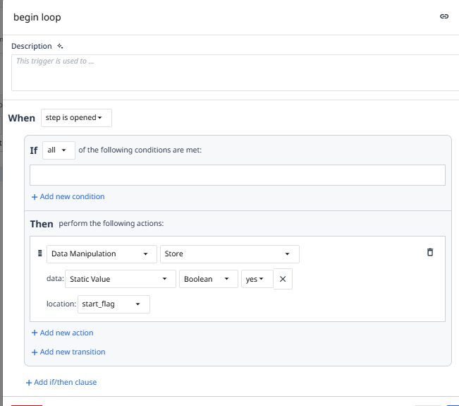

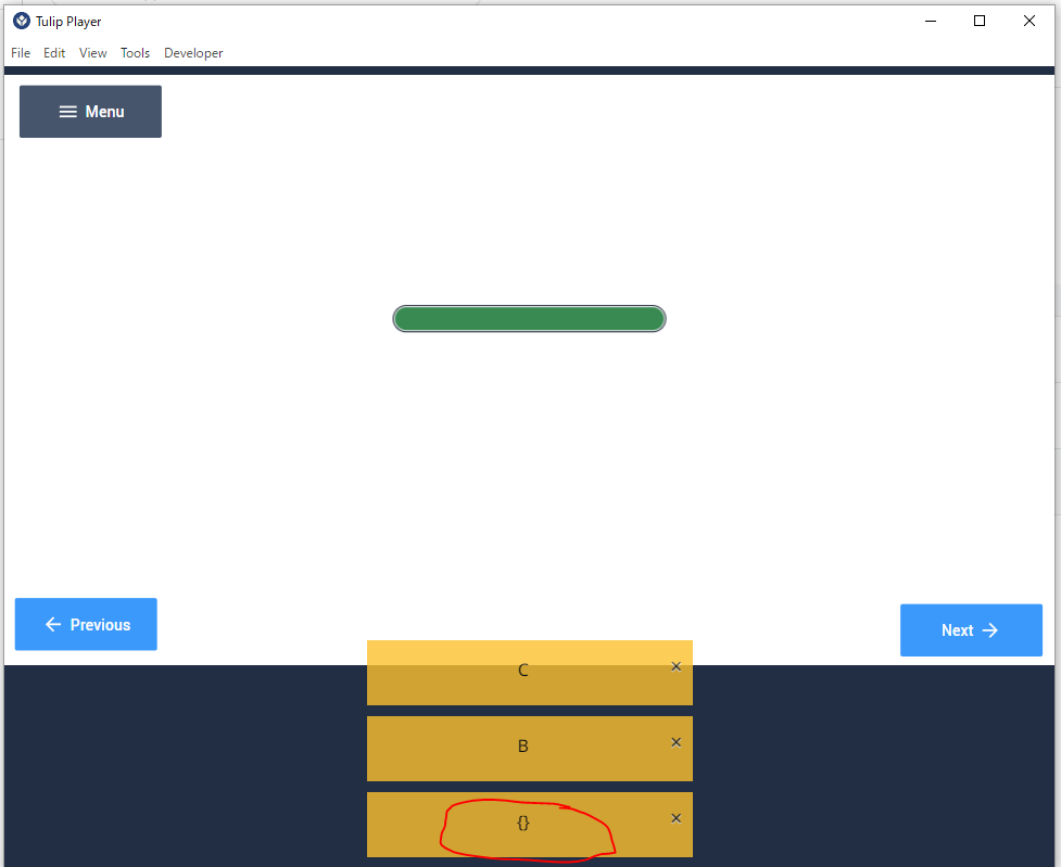

Please try this simple test App starting the looper v2.1 from the step enter trigger.
app.json (13.9 KB)
I wanted to see “A”, “B”, “C” appear, but I see “{}” instead of “A”.
I am guessing that this happens because SetValue is not having immediate effect.

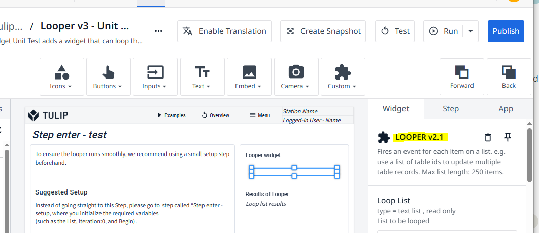

Where can I download/install the new Looper v3 ?
I went through Tulip library and knowledge base, but I couldn’t find the available link.
@Mihaly
I was able to download Looper v3 from the library. I will check how it works.
On the other hand, I guess this link on the Knowledge Base need to be updated. Please check.
I guess you need to rewrite this yellow part to v3.
The link is now fixed. Thank you.
This seems to be now fixed. Thank you.
I tested Looper v3.
Now it is working as expected. I see “A”, “B”, “C” appear correctly.

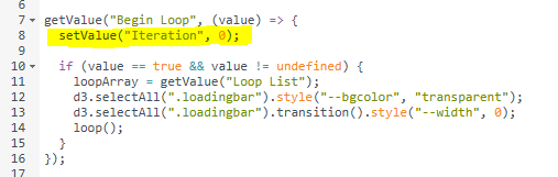

I read through the difference between v2.1 and v3 code.
It seems like adding “+0” to the v2.1 code will solve the issue I oberved.

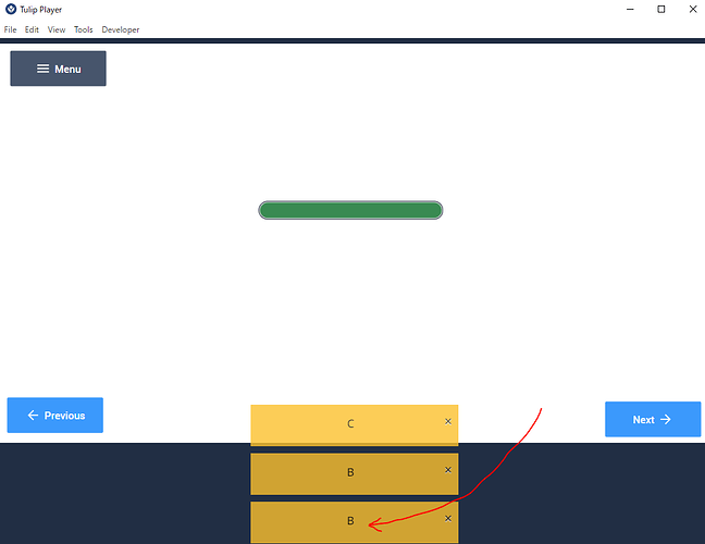

I found a problem in LOOPER v3. Please run this simple test App.
app.json (14.9 KB)
If you go to step2, I was expecting to see “A”, “B”, “C”, but I see “B”, “B”, “C”.
This happens if the “Iteration” prop is 1 before starting the loop.
As I explained in this post,
setValue("Iteration", 0);
does not work as a initializer.
I propose do something like
if(0 != getValue("Iteration")){
   fireEvent("Error", "Iteration not zero");
   return;
here, so that the loop do not start if the Iteration is not zero.

However, I still see this “B”->“B”->“C” issue.
This happens when “Iteration” was not zero when “Begin Loop” became true.
It happens because the initializer “setValue(“Iteration”, 0);” is having the effect asynchronously.

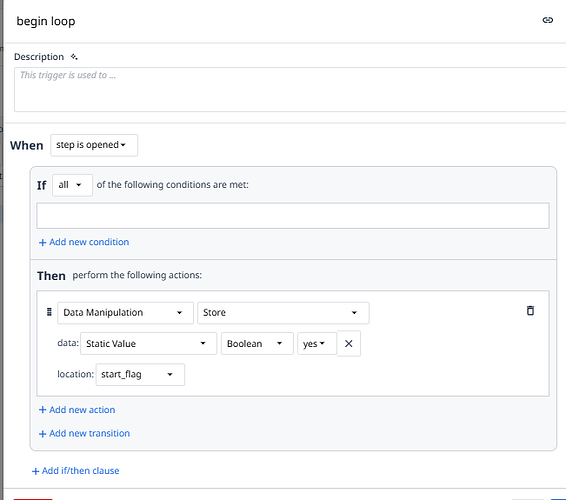

This is the screenshot.
Variables.
Props
“begin loop” trigger on step2 enter
