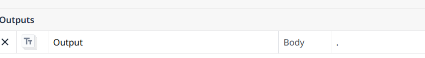

simply a . would extract everything into one variable, but usually it would be helpful to provide one value per variable.

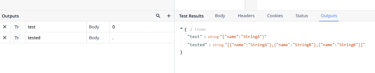

Sorry for the missing image
Here i got a json that do not start by “[” but by “{”
But thanks for the message above, i think “.” is the char i was looking for !
