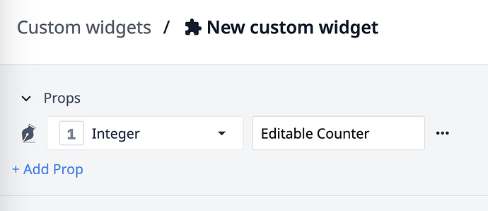

Hey Tony,
I think you will need to use a writable input to the custom widget which will store the current time remaining. When you add a prop to a custom widget, note the writeable button on the far left. What this means is that the custom widget can change the value of this and use a tulip integer as the true determinant of when to stop the timer. This will require refactoring your code a bit and doing the getValue() call every second.
Once this is set up, you can easily build a tulip button to trigger a change in this input prop. For example, a button to reset the timer to 60 seconds.
You should try this. I hope it will be helpful for you.
