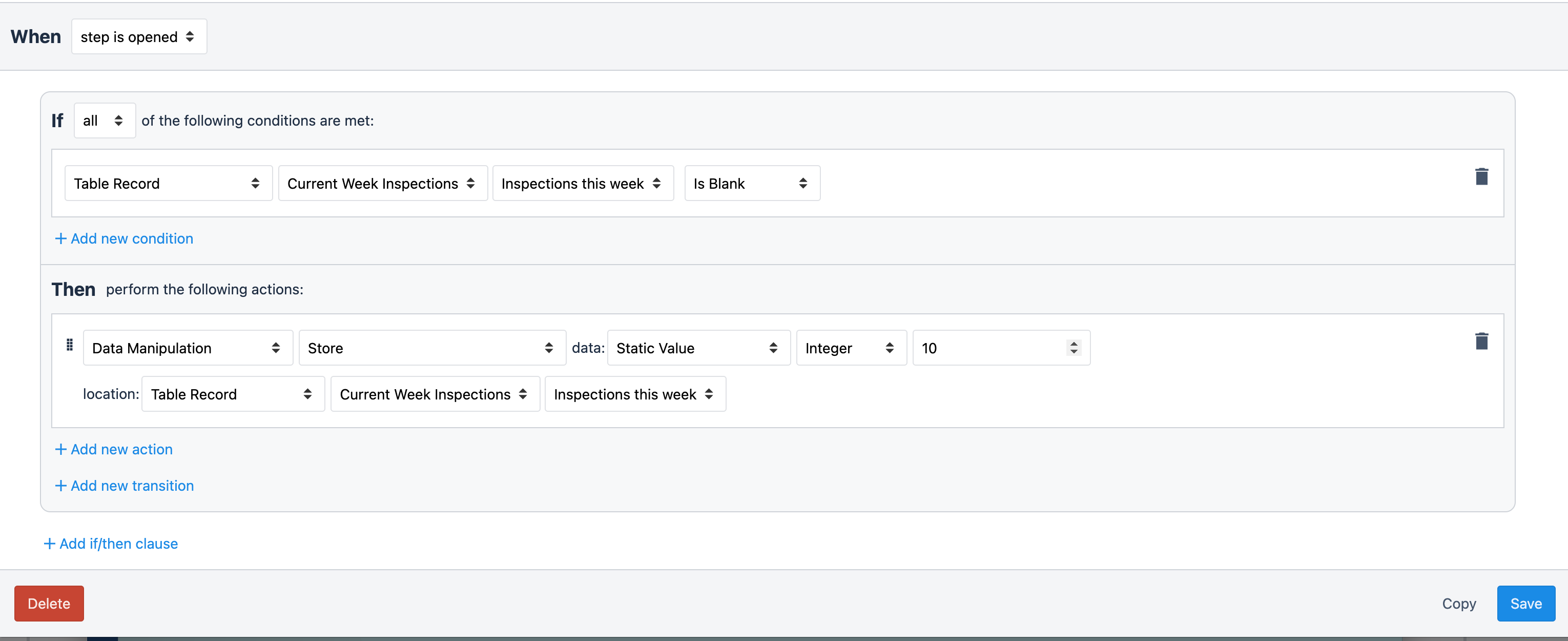

Thanks for the context.
Here is how I would do that-
- Create a table where you track each week with an inspections column.
- On step enter, I create or load a record with the YEAR-WEEK NUMBER as an ID.
- If the number of inspections is blank, set it to 10.
Does this achieve what you are looking for?
