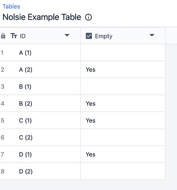

Here is my example table
In this case we would expect item A and B to trigger as needing replenishment.
