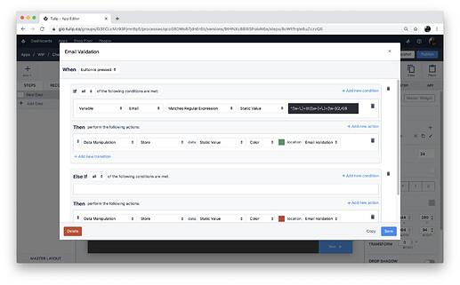

in the meantime, have you attempted to build validation in your app using triggers and color variables to notify Users?? for example, this simple Trigger checks to confirm an email has been input and changes the background color depending on whether or not the input matches the criteria.
Trigger:
postitive result:
negative result:
let us know if this would help in what you’re attempting to build!! and again, welcome to the Tulip Community.
