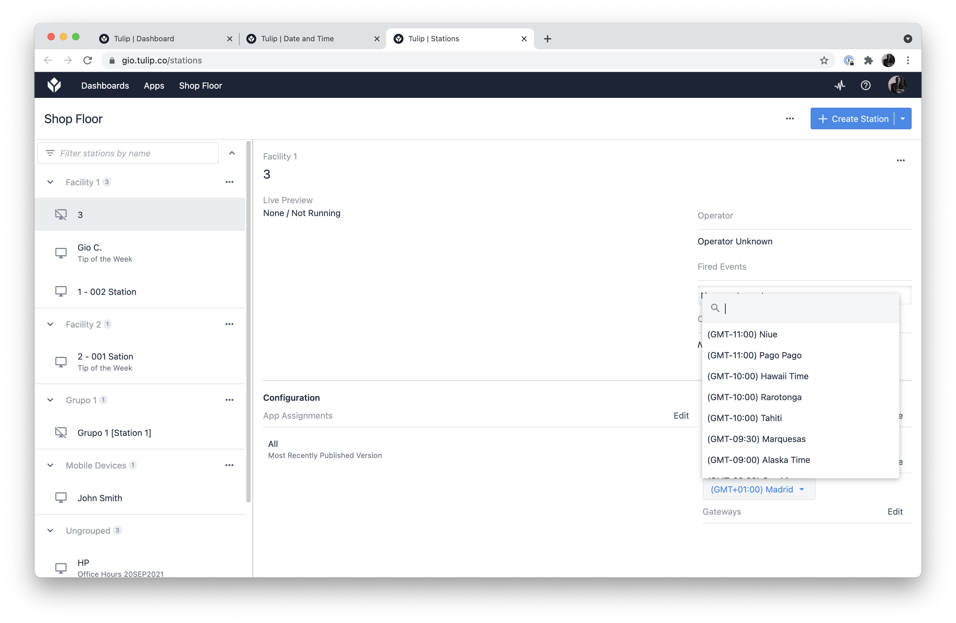

hello @psp316r,
you can customize the timezone from a couple places in Tulip, I believe these two are ones that you’ll want to modify:
Instance Timezone
Station Timezone
can you confirm that modifying these sets the timezone correctly?? thanks for posting!!
Hi @gio ,
Changed in the Station and in the Settings Tab, even though the dashboards time in different zones. As per our observation, APP INFO timezone changes based on browser or Device(In which Tulip is running) TimeZone ?
Shashi.
@psp316r have you tried changing the timezone in your browser or on the machine running your Tulip Player?? those settings could be causing the differences you’re seeing in the Dashboard.
what timezones are you seeing from the Completions tab??
