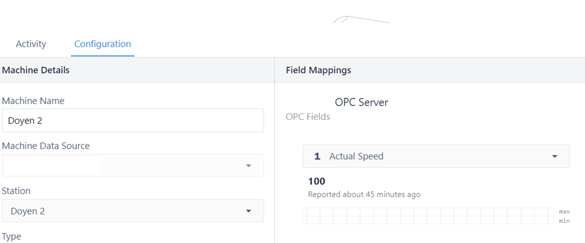

We have not set up the data store in table but now have a request to review speed trend. Is it possible to see the trend from field mapping? Thanks!

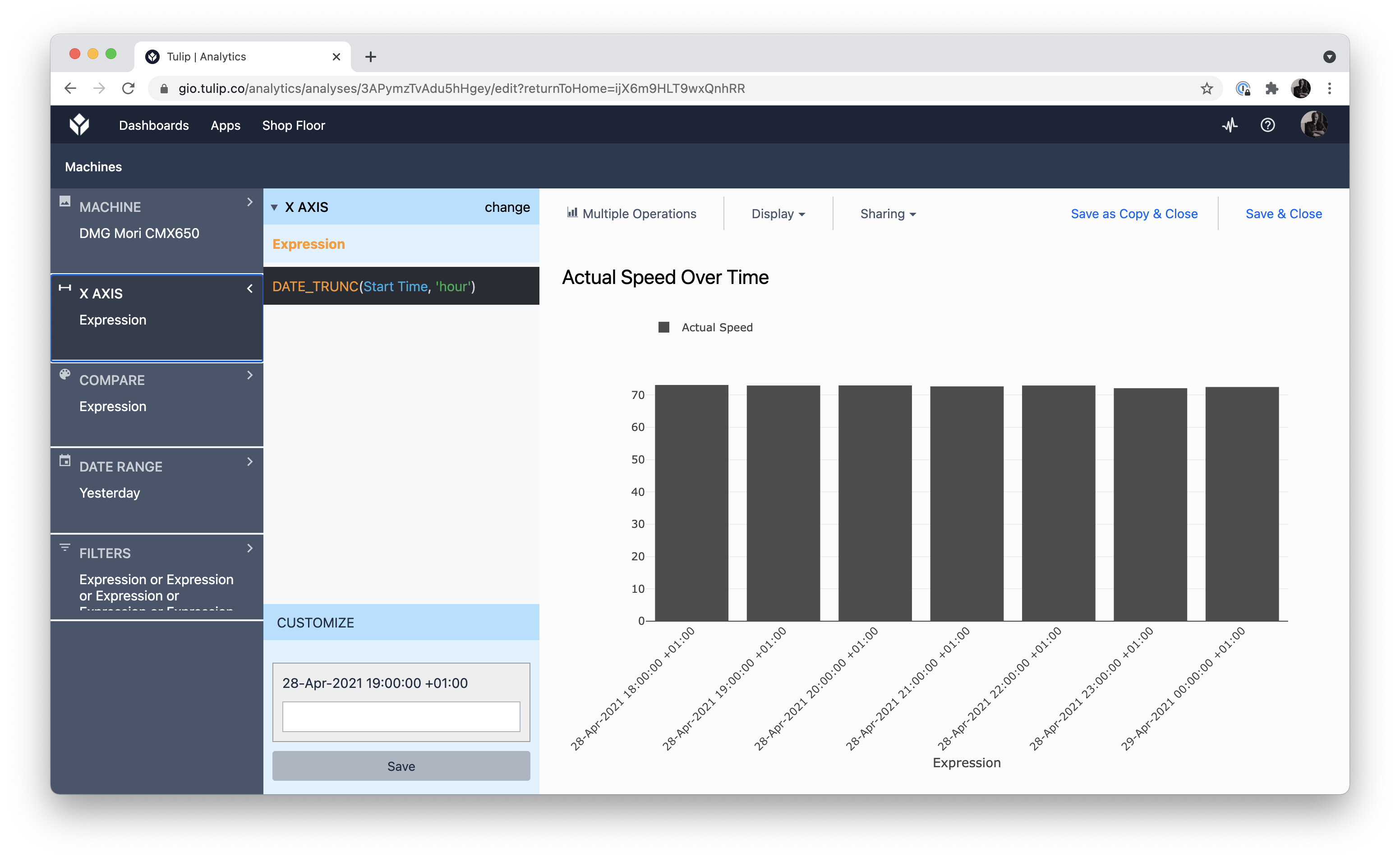

is the Machine changing State every time there is a new Actual Speed reported?? if so, you could build an Analysis to display the Actual Speed plotted over Time (grouped by hour, for example).
this would produce an Analysis similar to this one:
where the X-Axis is: date_trunc(@Start Time , 'hour').
have you taken a look at this article: Using Machine Data in the Analytics Builder | Tulip Help Center - Support for Building Manufacturing Apps on building Analyses with Machine data?? let us know if this is helpful!!
