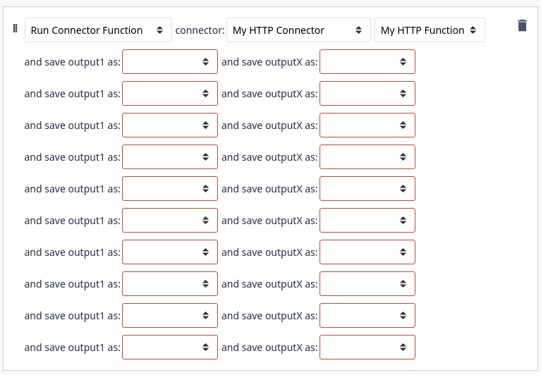

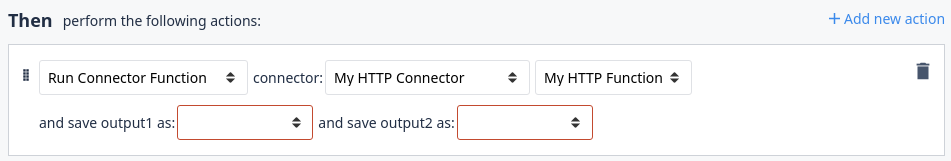

Going back to the ability for connectors to return multiple outputs, would you expect all Connector Functions to change their trigger menus to include every output? So if there are 2 Function outputs, then they would be broken into two different drop downs in the trigger editor as opposed to being two properties of a single object?
So for a two output Function:
And then a 20 output Function:
Where “outputX” would be replaced by the name of the output in the Connector Function:
I’m not sure this is something that we are able to do or that fits in with the future of the product, I’m just trying to understand if this is what you are trying to do.
