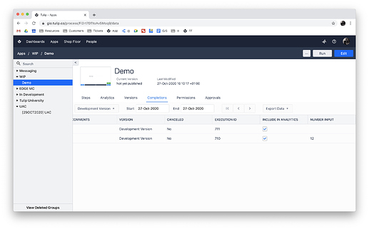

do you think you could share a screenshot of what you’re trying to achieve?? in general however, it is possible to have a Number Input be blank instead of a 0. see below:
Number Input:
Data in Completions tab (notice that NUMBER INPUT for the first completion is blank):
let me know if this helps and if you have further questions!!
