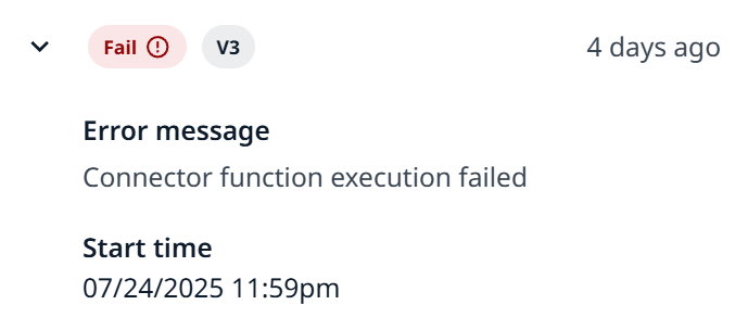

@OlgaStroilova Yes. Ideally we’d want to have a way that we can see at a glance any automation that has a run failure.
Then if possible a way to either re-run that specific run ID (useful in the case of a timeout). Or a way to see the underlying data that triggered the run, so we can have an idea of where to go to fix the error in the first place.
