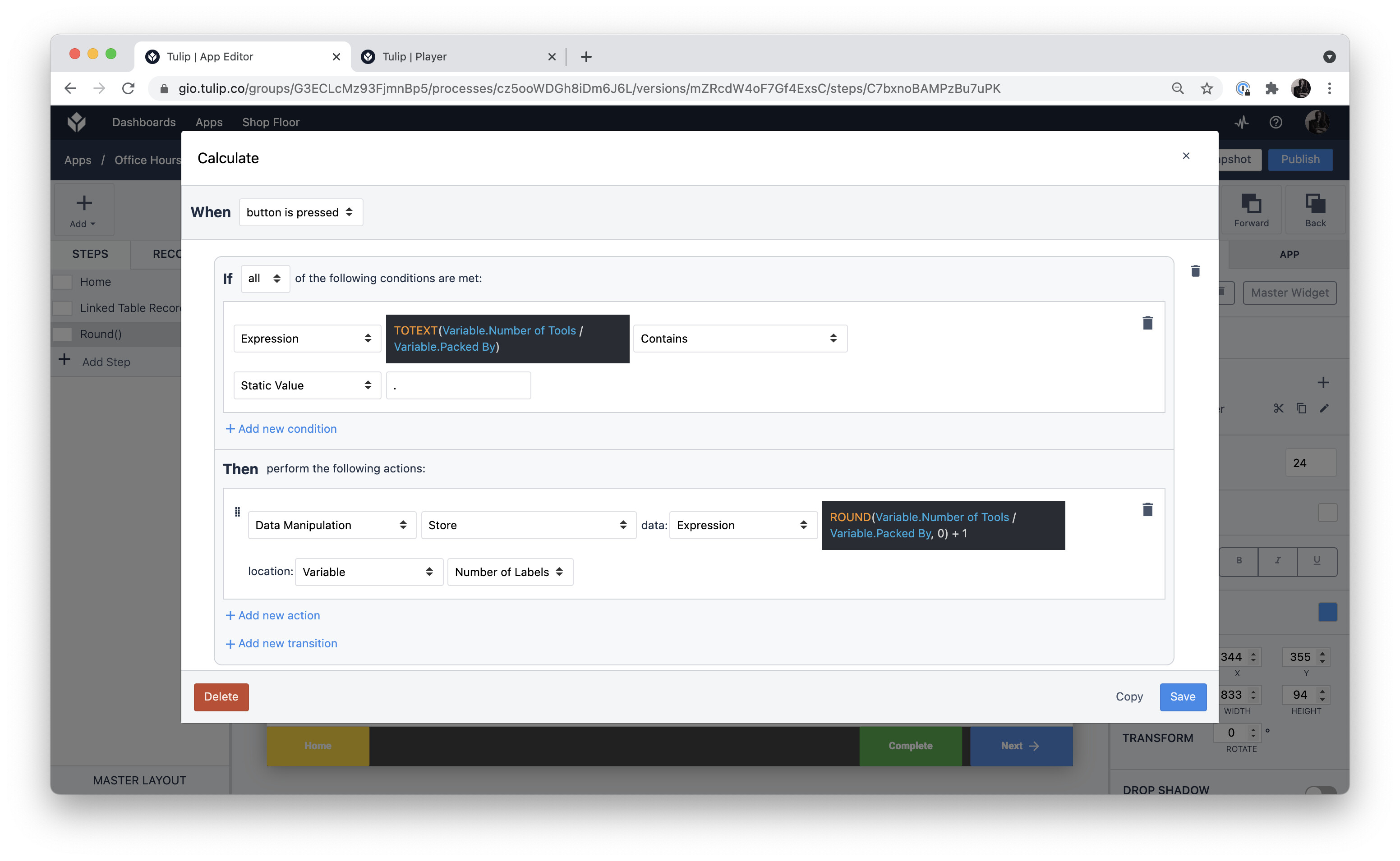

hello @Guillaume, that’s a great question!!

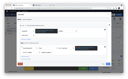

one way to solve this could be to add an If Condition that checks if there are decimals when dividing number of tools by packed by and adding 1 if so.
here’s a quick example. as you can see, if there is a decimal (meaning there is a non-full box) the Trigger adds 1 to the output while using the ROUND() function:

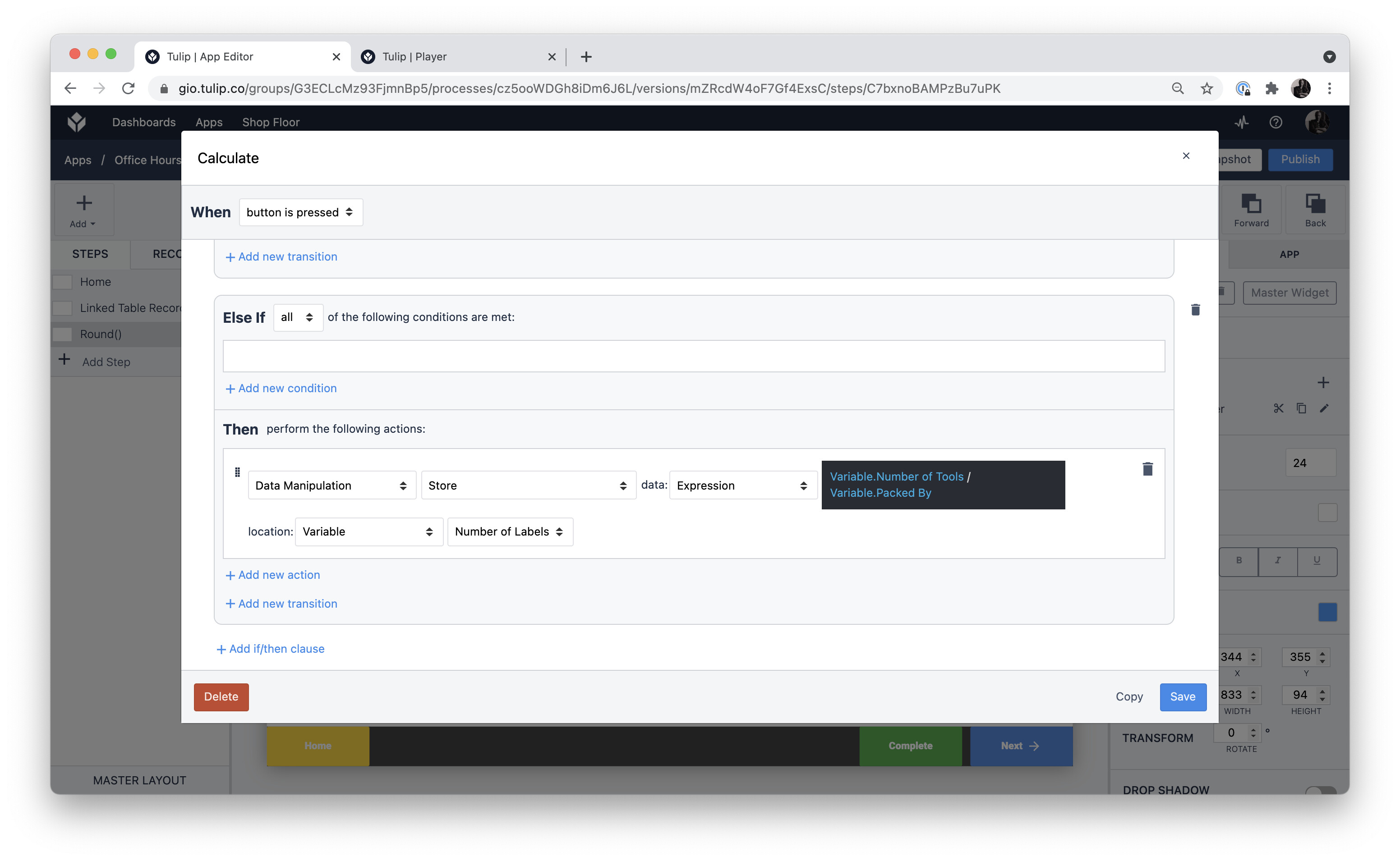

otherwise, it simply divides the number of tools by packed by:

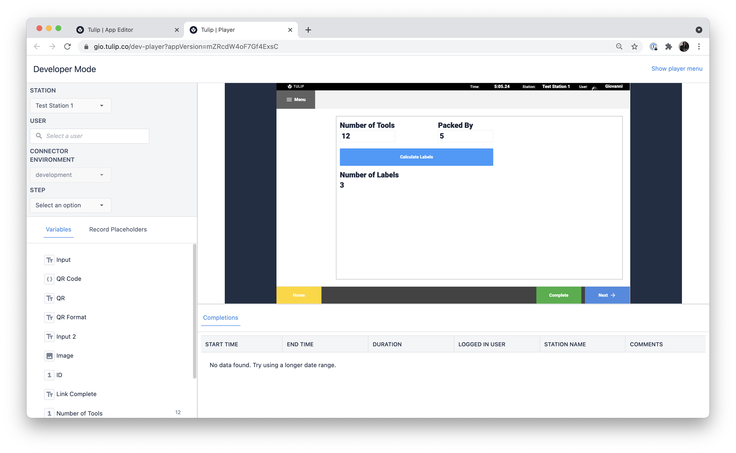

as you can see here, we’ll need to print 3 labels regardless is third box is full or not:
