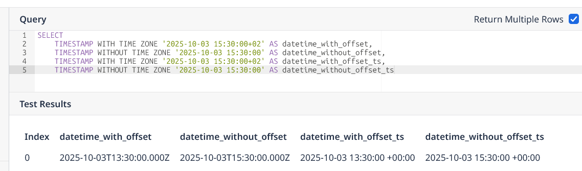

I was able to test this with a postgres database and did not see the same issue:
However, I assume you are working with a SQL Server connection? Could you try pasting the equivalent query and sharing your results. You will need to configure the outputs as shown above.

Daniel,
When I used the SQL script that you provided it works as intended. The issue is when the datetime is inserted into a SQL table and then subsequently selected from the table. Here is a test that I was running to show this.

Ok. Unfortunately, I don’t have access to a cloud SQL Server right now to do more investigating.
Maybe look into the way that the Tulip “User” is configured in your DB? Is there a time zone setting which might be influencing the way that `SYSDATETIMEOFFSET()` gets calculated?
If the test snippet worked then clearly Tulip is capable of parsing in offsets correctly. Something must be going inside your series of SQL commands. I am unsure how Tulip handles multiple SQL statements and what type of issues that may cause.
