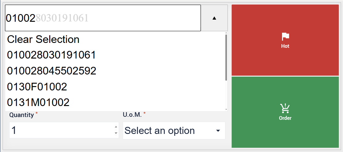

I have a custom drop down I use.
In order to see the dropdown list correctly;
  • Anything other widgets that are on a higher layer than the dropdown will overlap it, covering the options (and prevent selections).
  • Anything other widgets that are on a Lower layer than the dropdown will prevents interaction with anything lower than it
This is where a Click/Pass Through or Layer shifting would really help resolve this issue.
For this use case if you are able to use browser native dropdown functionality then you will not need to make the widget so tall. I cannot see what you are doing inside of the dropdown but if it is a standard dropdown then just use more standard html and the dropdown will actually work as expected with a regular sized widget.
The widget filters the list as the user input and provide an auto-complete.
The list is also longer that the tulip dropdown can use (aggregation 1000 record limit)
I’m not aware of how I could use the native dropdown (that is not the tulip widget dropdown). Could you provide more information? And would the native dropdown be able to fire triggers?
