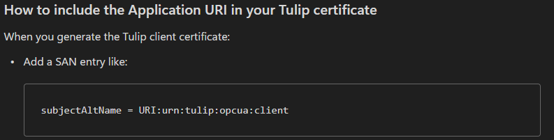

After chatgpt’ing this, it gave us bunch of suggestion and one seems to stand out, which was ‘Application URI mismatch (BadCertificateUriInvalid) → Regenerate Tulip cert with SAN URI that matches the client Application URI Tulip presents.’
In our cert, this ‘Subject Alternative Names’ field is missing. My next test would be to regenerate the cert with this SAN field (and it also seems to have a format) and try connecting again.

Just an update, we have got this working. Turns out two things were missing from the cert, first was the SAN entry as pointed out by gpt and other was KeyUsage extensions (found out about this on Ignition’s forum). The keyUsage entry should be like this ‘keyUsage = digitalSignature, nonRepudiation, keyEncipherment, dataEncipherment, keyCertSign’. With this we were able to connect to Ignition’s OPC UA with encryption.
