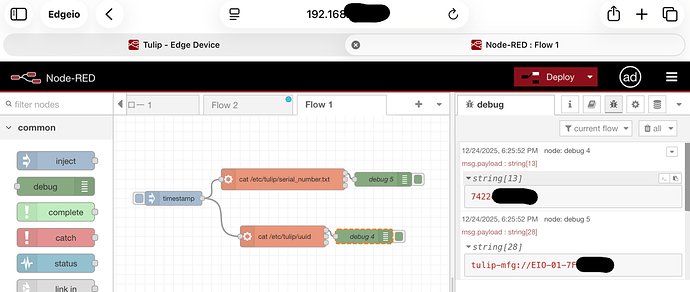

Please let me know if there are any official way of getting the name of the Edge IO name from the Node-RED running on it.
With few trial and error, I found out that I can get their name (EIO-xx-xxxxxxxx) this way on one specific device.
However, I do not know if this is a stable way to do it. (will it keep on working after firmware updates?)
Thanks for the question @ta-aoki .
Confirming that what you found is the currently recommended approach.
