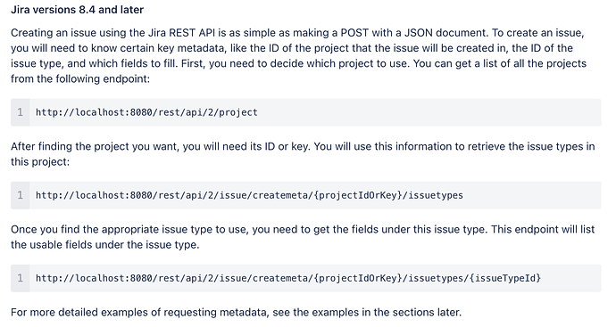

Hey @mswanson -
I think the issue you are running into is caused by the endpoint you are trying to hit. check out how jira explains this here:
https://developer.atlassian.com/server/jira/platform/jira-rest-api-examples/
This leads me to believe that you will need to get a project id, and issue type id, then hit the /rest/api/v2/issue/createmedia/[projectID]/issuetype/[issueTypeID]
