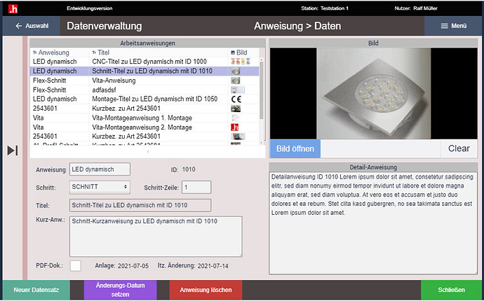

However, we have found that an added image only appears in the “Image Capture Widget” if it is also inserted via the widget. If the image is added over the table, the widget does not show the image.
So we re-uploaded all the pictures via the widget and everything seemed OK. The images were displayed correctly in all widgets.
After a few days, the images were not displayed in the “Image Capture Widget” again. In all other widgets everything is OK.
Attached is a screenshot. A picture was uploaded about a week ago and is not displayed. The other picture was uploaded yesterday and is displayed.
Is this a bug?

Hello gio,
here a screenshot of the Image Capture Widget from the App Bulider side. I hope that’s what you mean.
For example we use the “Image Capture Widget” for creation and editing of work instructions. If it work, we only need one widget (to show and change the image) and not another to just display the Image. See the scrennshot of our layout.
