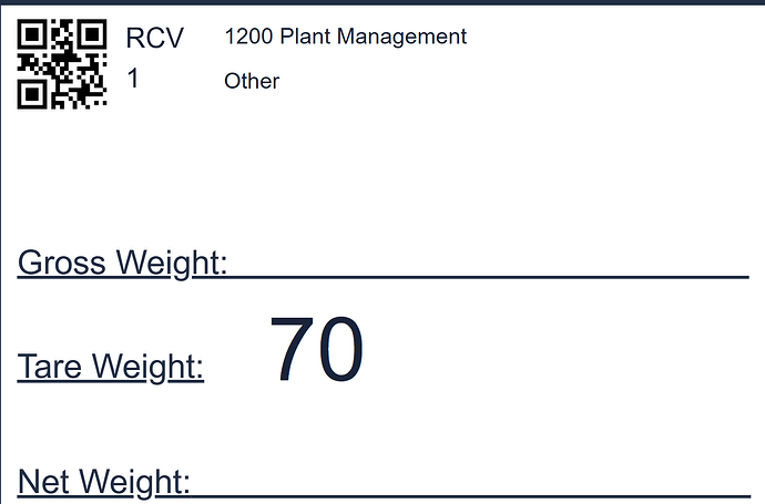

Yeah I ended up just building the report/document in its own app step. Then I applied a step open trigger to print it using the system dialog. I needed a barcode, so I embedded one that stored the ID value in it. The report below fits perfectly on an 8.5 x 11 sheet of paper.
