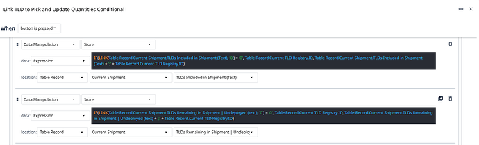

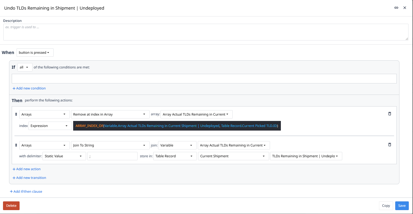

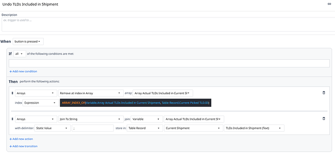

And here is one of the triggers for removing from the pick:
And here is one of the trigger for adding to the pick:

On the last image you check your text value against null
link(value, ‘0’)=’0’
if your text value is empty but not null, it will be false. That results in an empty string, that is joined with ; and the current ID => ;currentID
You could try four solutions:
  1. use len(value) < 1 instead of link(value,’0’)=’0’)
  2. add a trigger before to clear the variable if it is empty text ( if value blank then clear variable)
  3. use the trigger if value blank and built two if else statements where you have the the corresponding action
  4. clear the text variables before they could possibly get a value assignet. make sure, it has a real value or is null but never an empty string
I would prefer 1. or 2.
Indeed, I replaced the LINK() logic with an IF(LEN() expression and that solved for both null and emptystring scenarios. I’ll go back and see if we didn’t have that as an option in LTS 8 or this was just a miss.
