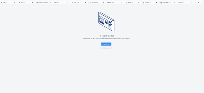

There are no error messages, when we press on the button the data get’s added on the Table which is on the Dashboard, but when I go back to tables and check the data is not added, Pls check below screen shots.
Records in the Backend Table:

I am also having the same issue. I can see in developer mode that the values are being stored in the Record Placeholder but when I check in the table, its not coming up.

The developer mode by design does not store data in tables. This is its normal behaviour.
You can find more information on the developer mode here: How to Use "Developer Mode" To Test Apps | Tulip Knowledge Base - Support for Building Operations Apps.

Yeah it works in Player. Thanks
