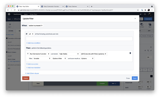

would something like this work for you??
the user will need to click an Update Button, but it does seem similar to what you’re describing. on the Update Button, you run a Connector Function with a filer to get the filtered list of ID’s from a Table you’d need to create with the complete list of Options.
Trigger on Update Button:
Connector Function:
Options Dropdown:
Options Table:
would this work as a solution for you??
