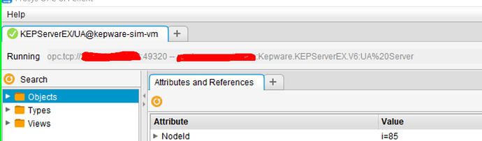

Able to connect the OPC UA Server with Prosys UA Client(In Local Machine), but was not able to connect in the Tulip and facing following error :
Connected in Prosys
Any solution ?

Hi @gio
Connected in Prosys
Any solution ?
Shashi.
